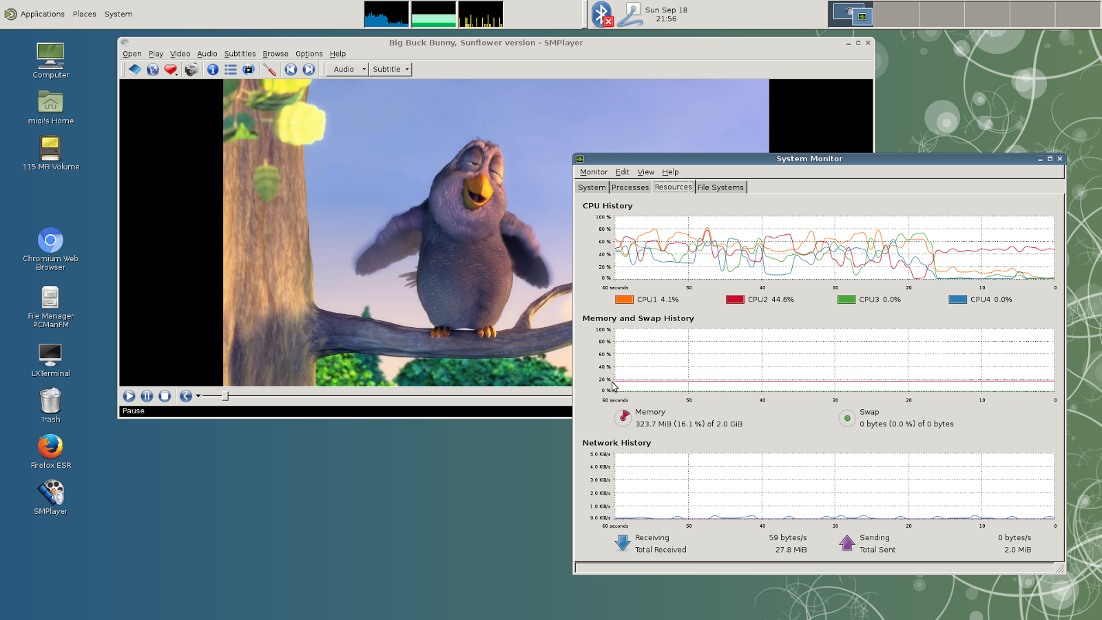

Firefly  keep moving on the open source area£¡this time  we bring you the lastest ubuntu 16.04 .
the new function:  Dual Display
the  problem of chromium-browser has finished.
GPU: higher performance
Dowdload this firmware from here:
baidu £ºhttps://pan.baidu.com/s/1i50kLdb
google £ºhttps://drive.google.com/open?id=0B7HO8lbGgAqAemxZUThVdWlqU2M

it has 3D support (opengl es ) and video acceleration (VAAPI <only h264 >).
