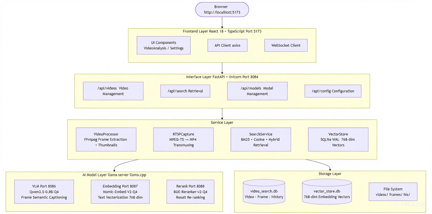

Technical ArchitectureSeewise uses a client-server architecture with three layers:
- Frontend Layer: A modern web interface for video upload, search, and real-time processing updates.
- Application Service Layer: Handles business logic for video processing, search, and data management.
- AI Model Layer: Performs image analysis, text vectorization, and search result reranking.

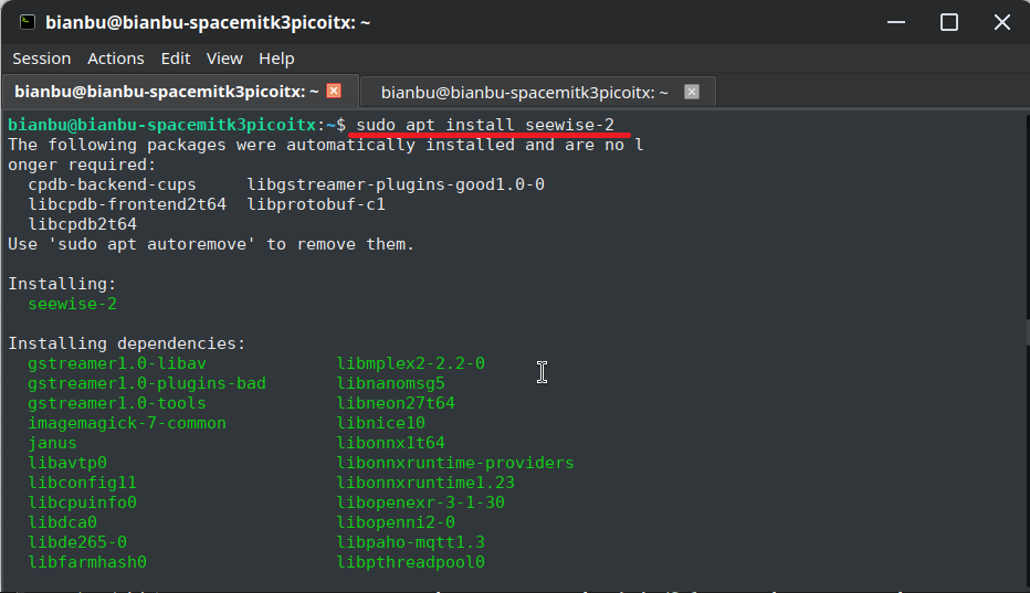

Install the Debian Package
For production deployments, installing the local package with apt is recommended:
- sudo apt update
- sudo apt install seewise-2
Copy the code
If dependency issues occur, run the following command:
After installation, seewise-2.service is created and enabled automatically.
- Default root directory: ~/.seewise-2
- Runtime dependencies include llama.cpp-tools-spacemit, spacemit-onnxruntime, and python3-spacemit-ort

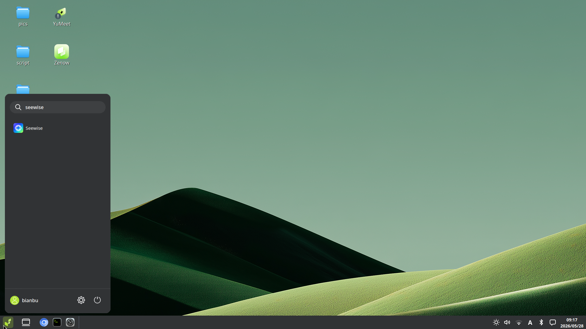

Quick Start- Web Access: After installation, open http://<board-ip>:8084 in a browser.
- Desktop Access: Open the application menu in the lower-left corner, search for Seewise, and click the icon to open the corresponding web page.

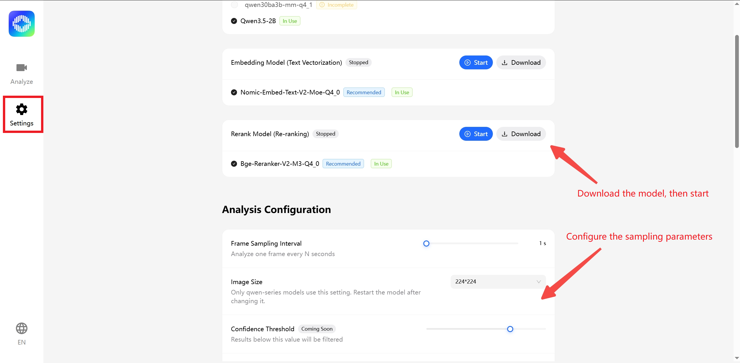

Model Download and Parameter ConfigurationDownload ModelsFor production use, download models from the Settings page in the Seewise web UI.
Default model directories:
- VLM: ~/.seewise-2/models/vlm/fastvlm-mm-0.5b-q4_1/
- Embedding: ~/.seewise-2/models/embedding/
- Rerank: ~/.seewise-2/models/rerank/
It is recommended to use the default recommended models.

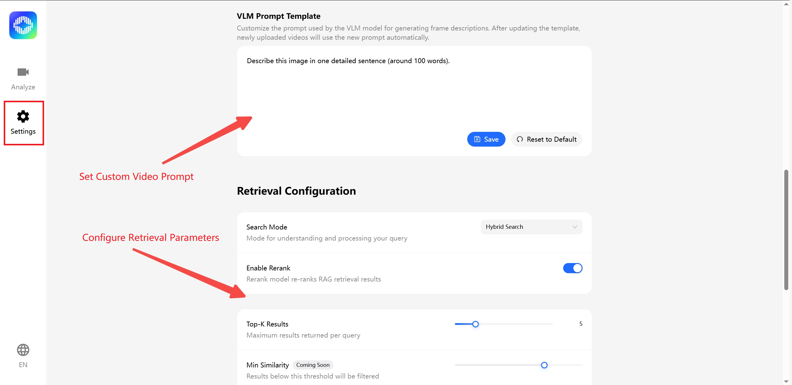

Configure ParametersThe main configurable settings include frame extraction and retrieval parameters:
- Frame Extraction Settings: Define the frame sampling interval, which determines how frequently frames are extracted from the video.
- Image Size Settings: Define the model input image size, which affects both retained detail and inference time. Larger images preserve more detail but require more processing time.
- Retrieval Settings: Control the search strategy, including whether reranking is enabled.

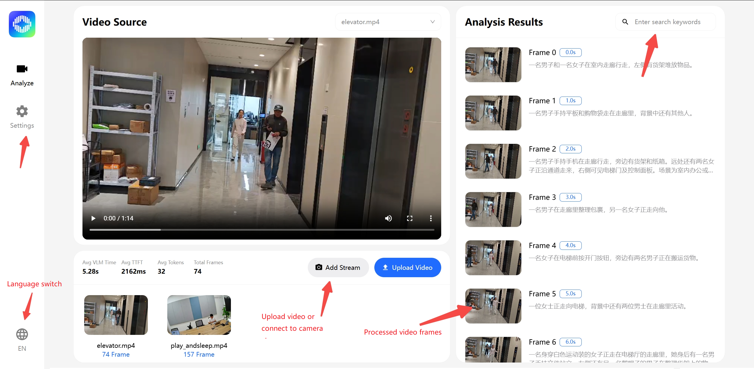

Video Upload and RTSP Retrieval Workflow
Local Video Upload Workflow- Select Upload Video in the frontend interface.
- The backend saves the file to data/videos/.
- FFmpeg extracts frames and generates output in data/frames/ and data/thumbnails/.
- The VLM generates frame-level semantic descriptions.
- The embedding service generates vectors and writes them to the vector index.
- The processed video is indexed and ready for search.
RTSP Live Stream Workflow- Enter the RTSP address in the frontend interface and start the connection.
- The backend uses RTSPCapture to record the stream and save it as an MP4 file.
- FFmpeg then extracts frames and generates thumbnails.
- Processing progress is pushed to the frontend in real time through WebSocket.
- When processing is complete, frame data is written to both the database and the vector index.
Search Workflow- Upload a video or connect to an RTSP stream, then wait for processing to complete.
- During processing, a progress indicator appears in the lower-right corner of the video player, and keyframe previews appear below the search box.
- Enter a natural-language query in the search box and press Enter to search for relevant content.
For best results, use the retrieval configuration options available on the Settings page.
