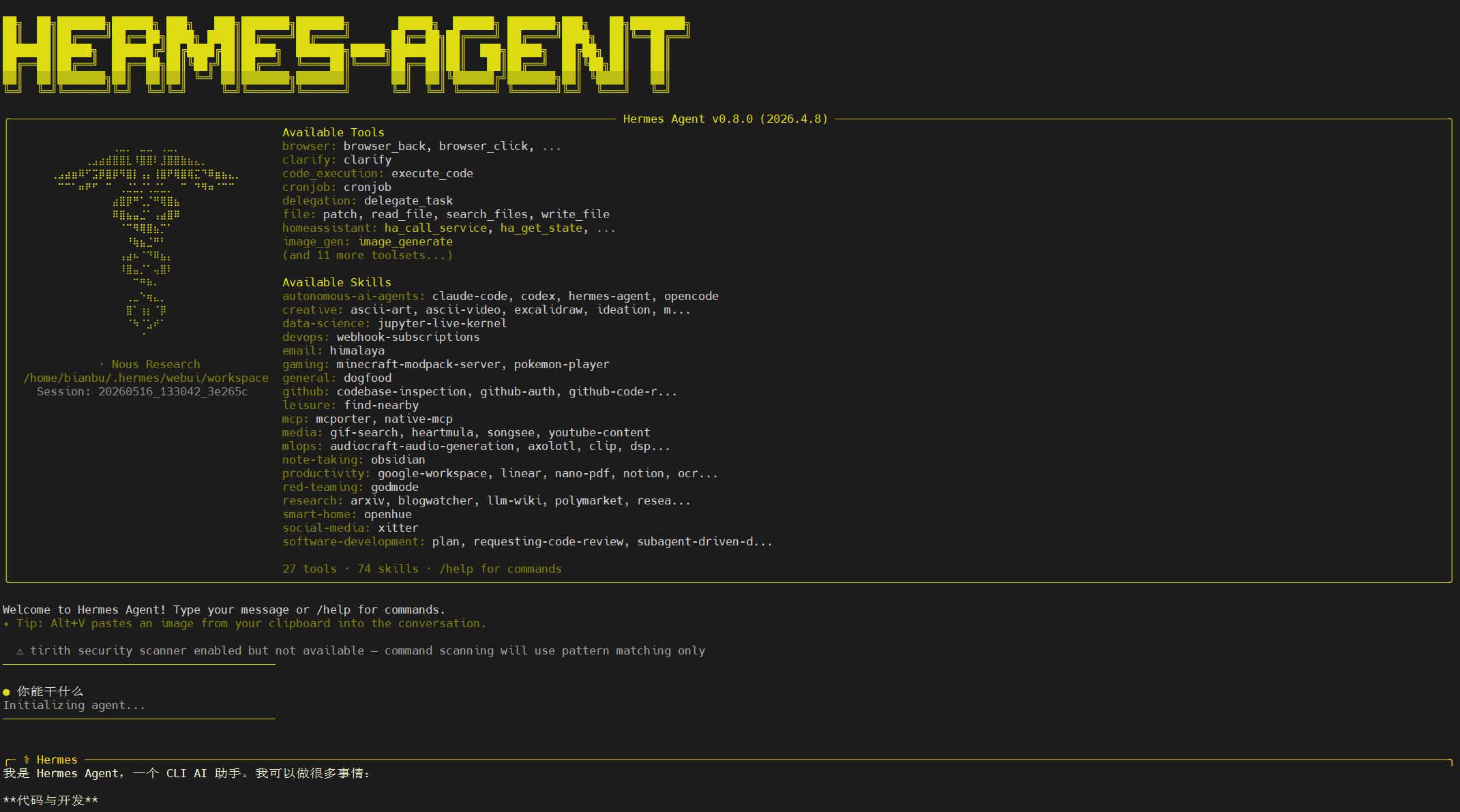

For an apt installation, run:
  1. hermes
Copy the code
For a source installation, activate the virtual environment each time you open a new terminal:
  1. cd hermes-agent
  2. source venv/bin/activate
  3. ./hermes
Copy the code
