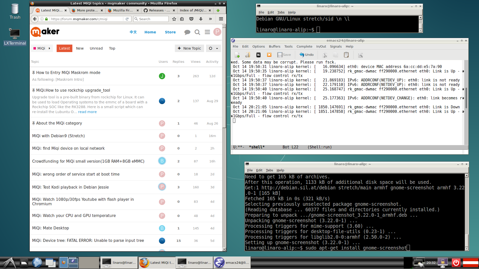

Posted at 10/15/2016 18:21:07      View:15997 | Replies:9        Print      Only Author   [Copy Link] 1#
http://www.bitkistl.com/2016/10/ ... qi-device-from.html
https://forum.mqmaker.com/t/miqi-with-debian9-stretch/568
Mali drivers r9p0 and 2D/3D GPU acceleration via glamor works.
